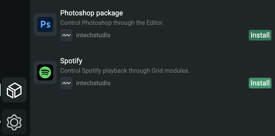

  1. Install the Photoshop package through Editor
Photoshop package

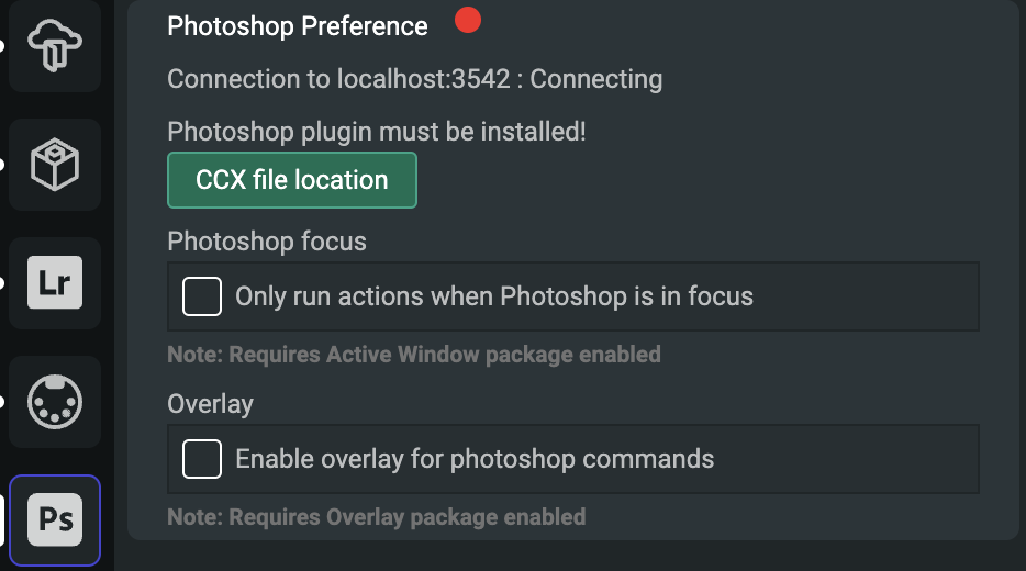

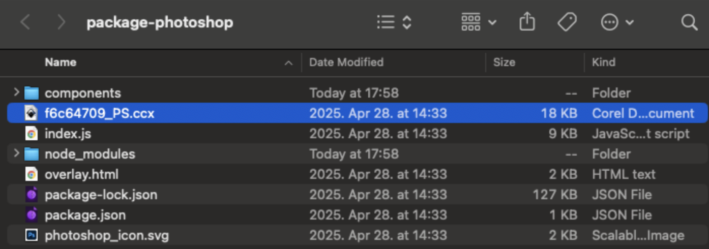

  1. Click on the CCX file location button.
  2. Double click on the file with .ccx extension

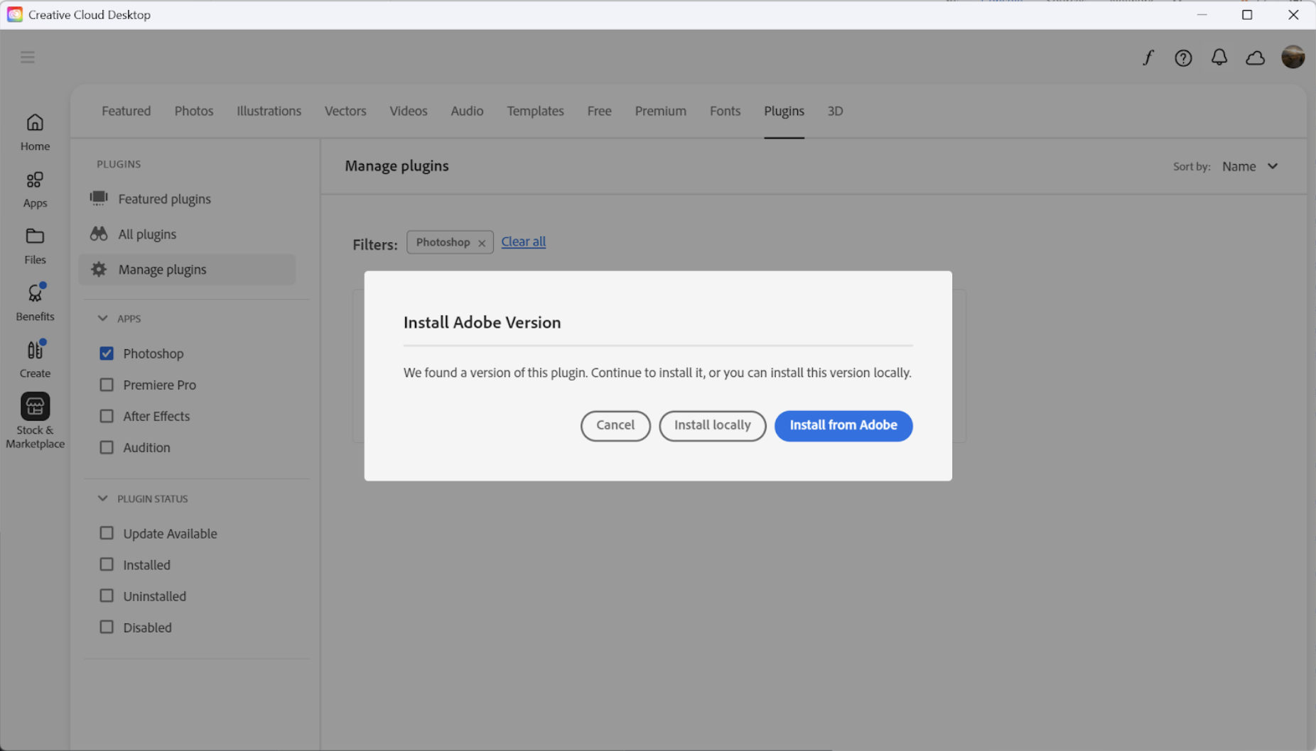

ccx
  1. Select “Install locally”, then “OK”

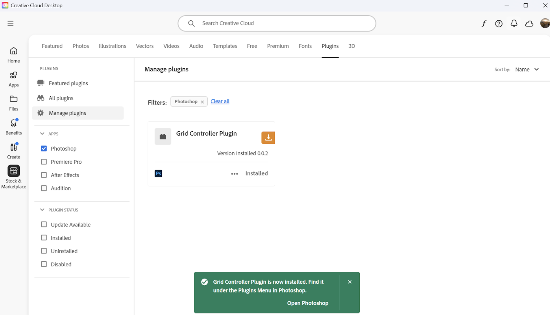

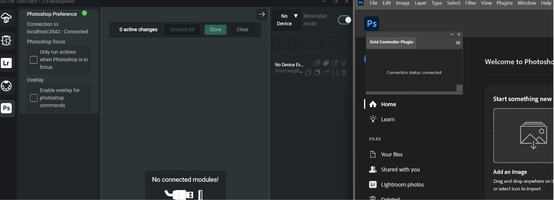

  1. You should see the Grid Controller Plugin installed in the window:
Grid Controller plugin
  1. The plugin should automatically start, shown by a small status window showing “connected”. The package preference should also show the successful connection. You can close the Photoshop plugin window, it can run in the background.
Connection

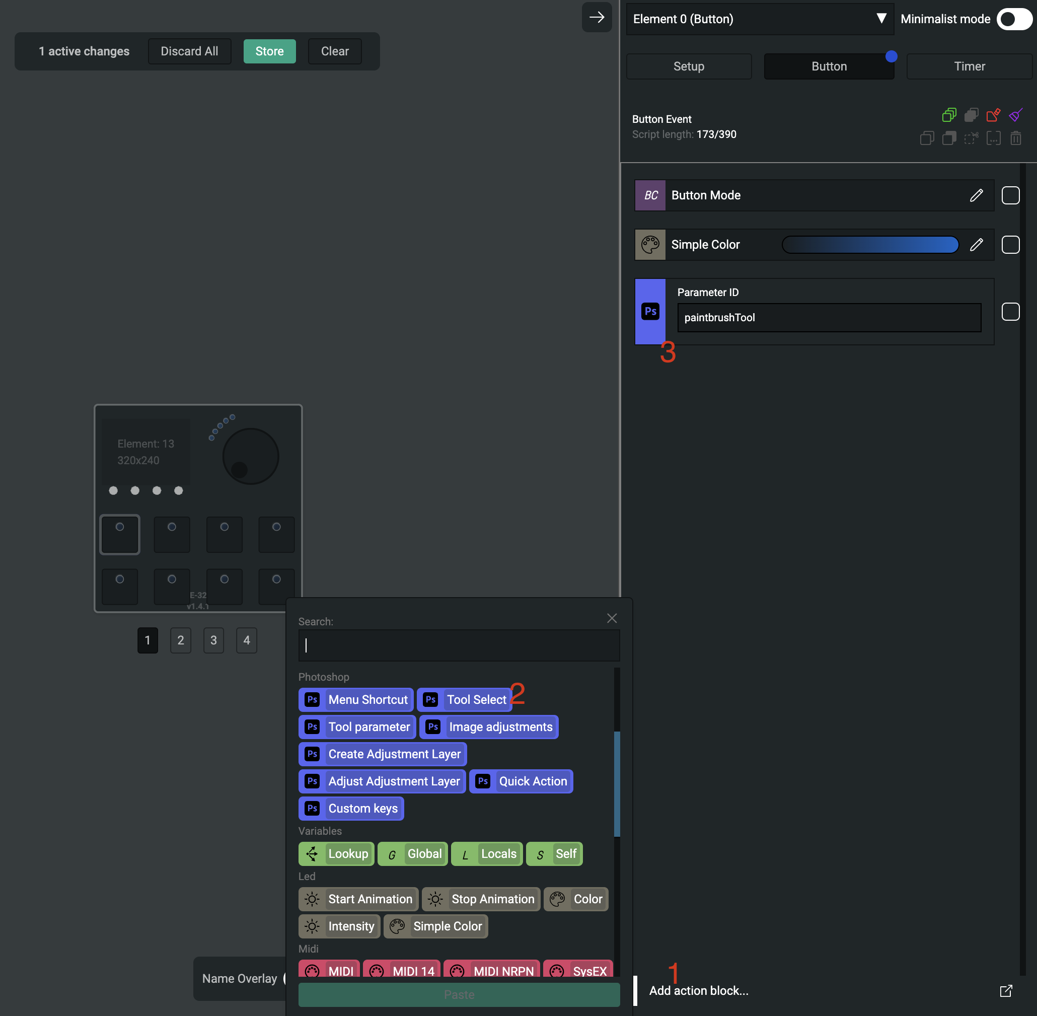

  1. From the action block picker, add a “Tool select” PS action block to quickly confirm everything is connected.
Add Tool Select
