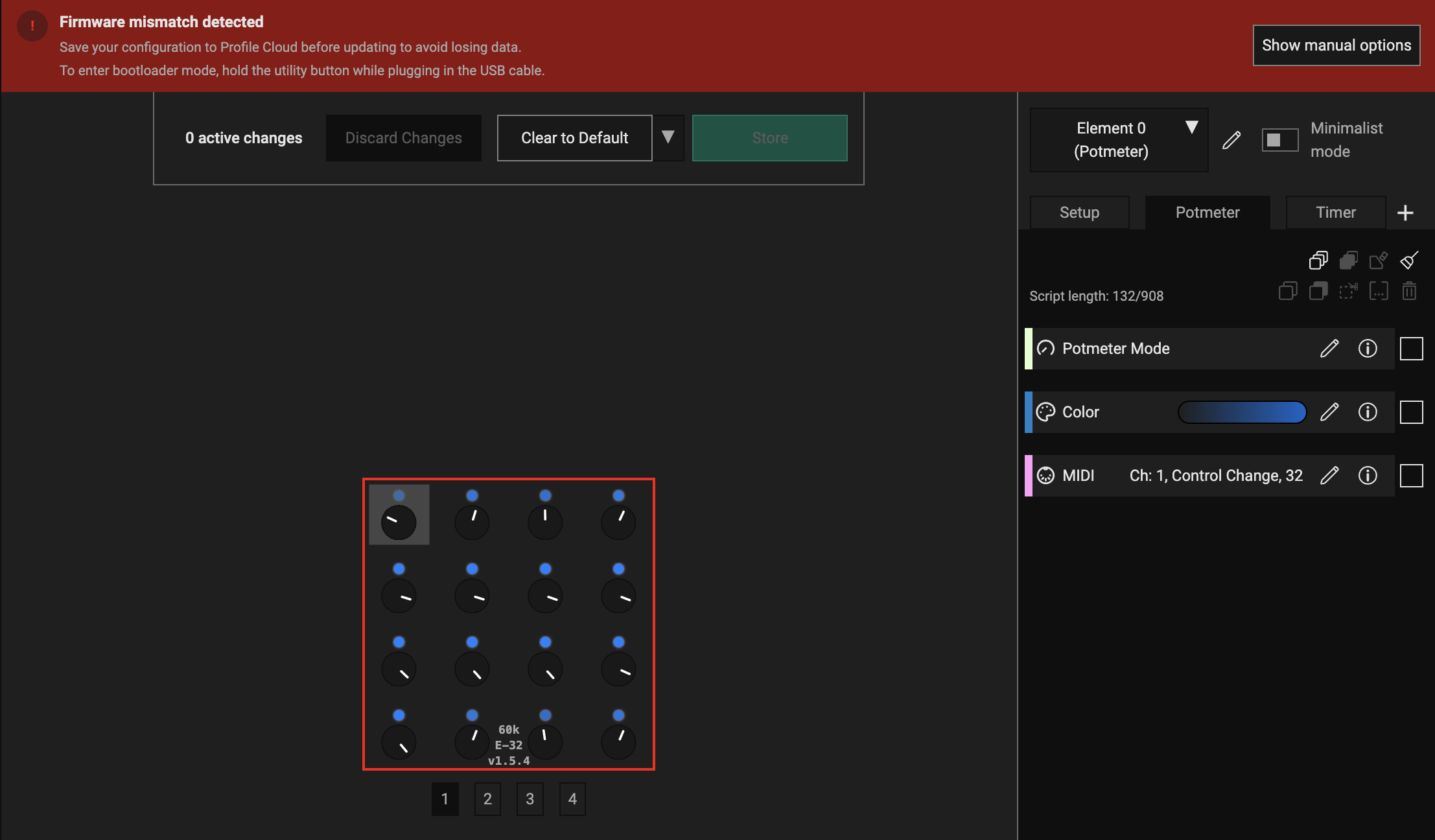

Whenever you're prompted with the Firmware mismatch detected message while running Grid Editor means you have a module plugged in with an outdated firmware version compared to Editor.
Firmware Mismatch
When encountering a firmware mismatch, you could update your module firmware for each module as we believe that each firmware version is better than the last one.
But the most important thing should always be that you run the same firmware version across all of your modules, even if they are outdated!
The mismatched module will be highlighted with red color, like this:
Modules running outdated firmware versions are highlighted in red
Gird Editor can update your module firmware automatically if you follow the on-screen messages at the top.

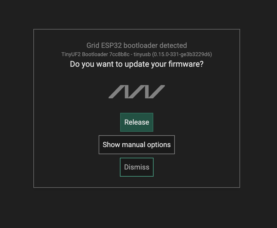

Reconnect the mismatched module (and that module only) while holding down the utility button on the side of the module.
After connecting you'll a popup appears. Press Release.

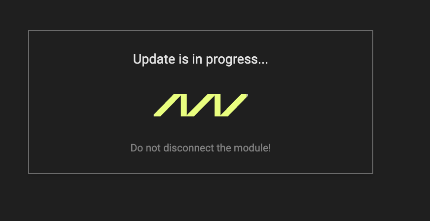

Don't disconnect the module while the update is running or the update will fail.
Update running

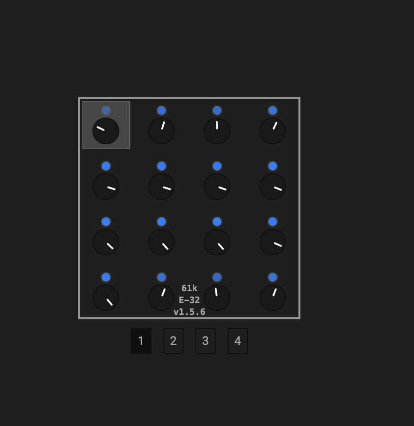

The module should then appear without a red border.
A freshly updated module
Congratulations! You've successfully updated the firmware of your module.
