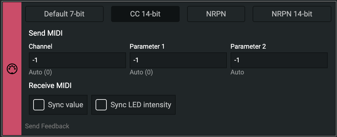

14 bit MIDI - High resolution MIDI message format.​
Please note, as the least significant bit (LSB) and most significant bit (MSB) calculations happen in the background with a CC offset of 32, the second parameter CC number can't be larger than 95.
14bit midi
To use this feature, you must change the control element's resolution and maximum value (16383).
On System Event Element settings changed max Value to 14bit and Resolution to 10bit
