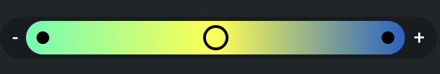

Simple Color is on all elements by default. It's easy to use, but it allows you to make detailed adjustments to the element LEDs. You can set minimum, middle, and maximum colors and alpha values. For example, if you want to highlight when the encoder is in the middle position, you can assign a specific color to that point.
If you want to use coloring for value feedback, you can add minimum and middle value colors. By pressing the '+' button, you can assign these minimum and middle LED values.

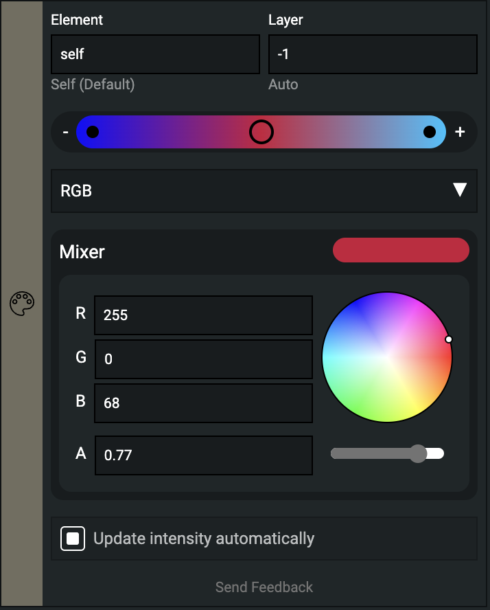

The Block has several fields you can configure:
- Element (hidden in Minimalist mode): defines which LED the Block should affect.
- Layer (hidden in Minimalist mode): can be either 1 or 2. The final color is based on the mix of both layers.
- 1: button and potmeter event layer
- 2: encoder and endless event layer
- Color strip: you can add or remove minimum and middle LED values and choose which to color in the color picker.
- Color Mixer Type dropdown: you can use RGB, Classic, or HSL style color picker.
- Color Mixer: you can type in your own RGB values or pick a color and alpha value.
- Update intensity (hidden in Minimalist mode): when enabled, the intensity will update automatically.
