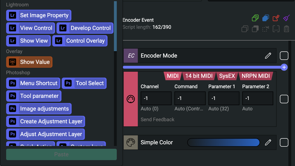

Adding a block is possible in different ways:
- Use the Add Action Block… button to add an action block to the bottom of the chain.
- Or select the exact place by moving the cursor between Actions.
- You can drag and drop an Action Block to change its order or move it to another element.
Add action block to the bottom
Add action block to a specific place

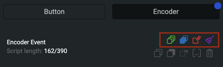

Element Operations
If you want to duplicate the configuration of one element to another, select the Element on the Grid layout panel in the middle and then Cmd/Ctrl + C to copy and Cmd/Ctrl + V to paste it to another selected Element.
You can also use the icons to:
- Copy – Duplicate the element data to the clipboard.
- Paste – Paste the element from the clipboard.
- Discard - changes and revert to the previously stored settings
- Clear - the entire element back to the factory preset
Element Actions
All of theses Operations are also available by right-clicking the element on the Grid layout panel.

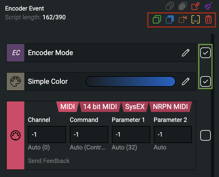

Action Block Operations
When selecting one or more Action Blocks, you can perform the following actions:
- Copy – Duplicate Action Blocks data to the clipboard.
- Paste – Paste clipboard data to the element.
- Cut – Remove Action Blocks and copy it to the clipboard.
- Merge – Combine Action Blocks and merge into Code.
- Delete – Remove Action Blocks from the element.
Operations of the selected Action Blcoks
