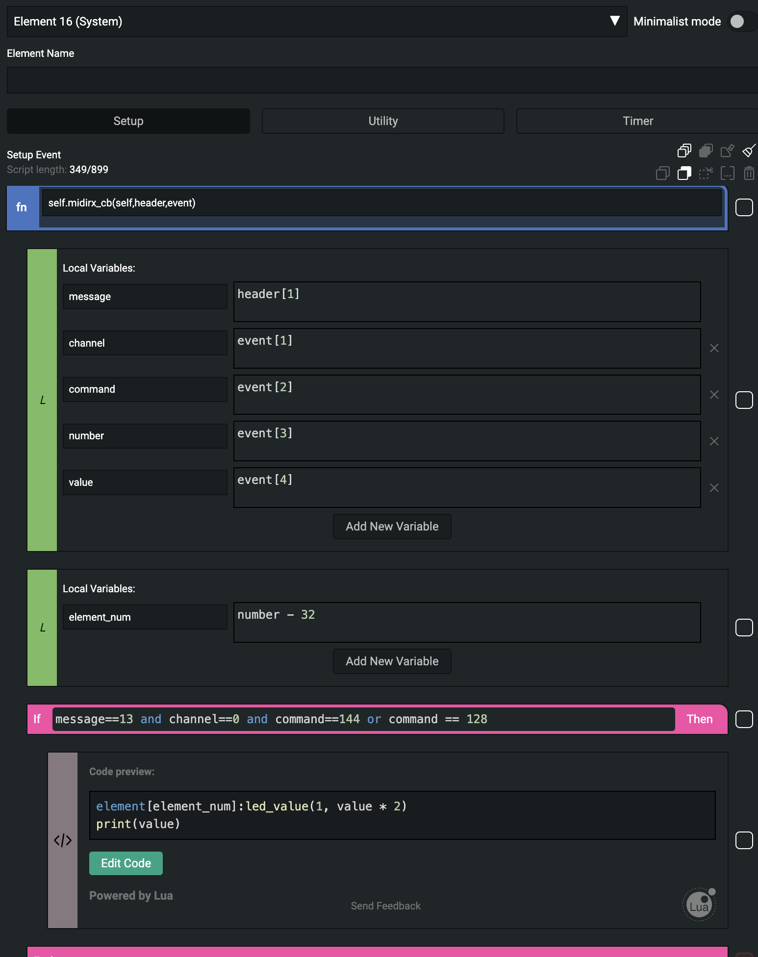

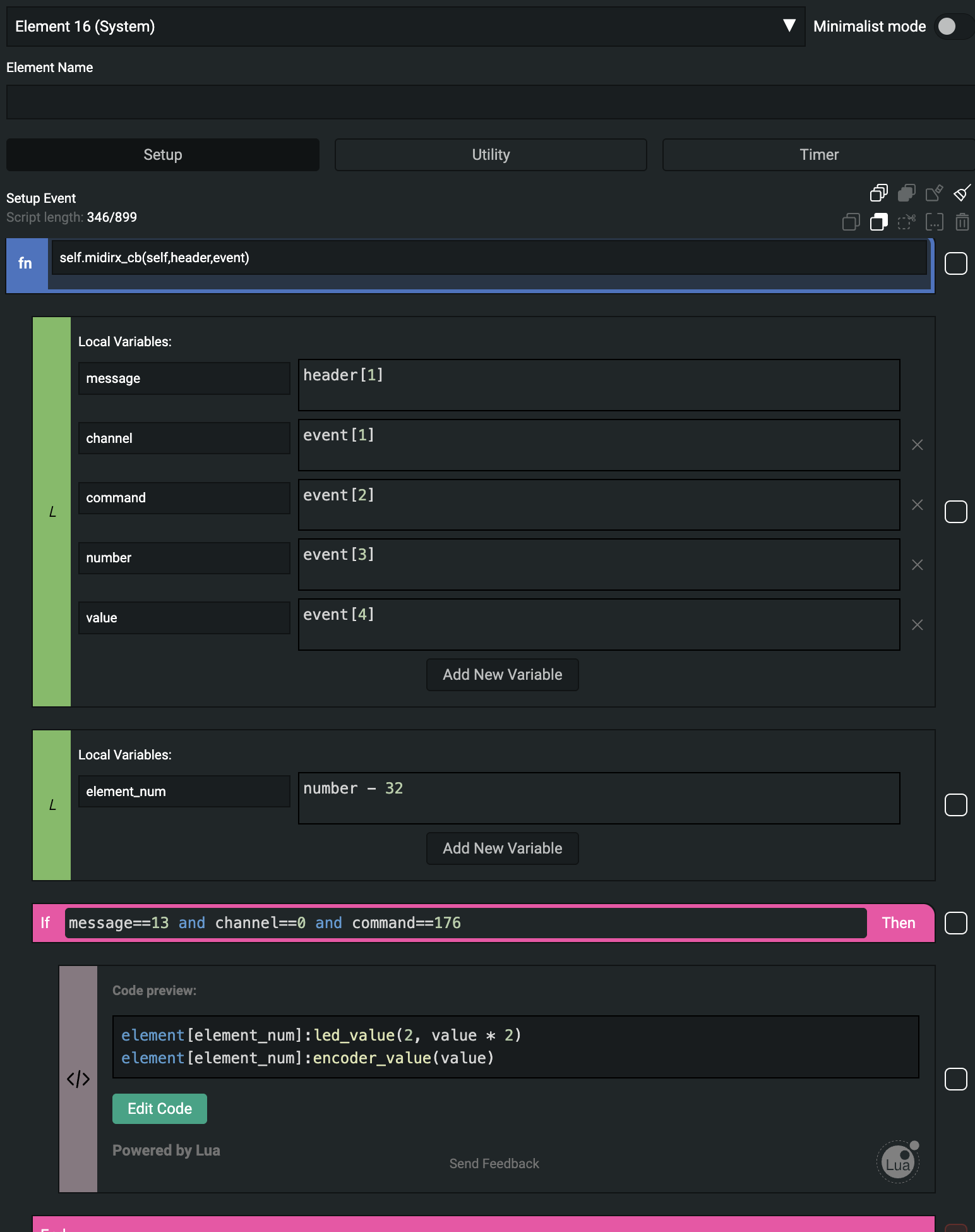

To handle incoming MIDI messages, you need to use the following callback function in the System element's Setup:
self.midirx_cb(self, header, event)
header Parameter​
The header parameter is useful for filtering incoming messages. We typically use header[1] = 13, which means the message is coming from a DAW, synth, or other external gear.
event Table Structure​
  • event[1]: Channel (0–15)
  • event[2]: Command (e.g., CC: 176, Note On: 144)
  • event[3]: Param1 (usually the CC or Note number)
  • event[4]: Param2 (usually the value)

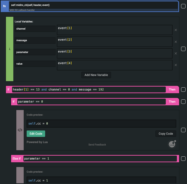

Example: How to Receive Program Change Messages with Encoder​
MIDI RX callback
1. Load the Correct Profile​
  • Load the profile from Profile Cloud: "midi rx program change".
2. Enable Advanced Editing​
  • In the editor (top-right corner), turn OFF Minimalist Mode.
  • Go to:
    • Encoder → Setup
  • You will see the code blocks.
3. Understand the Parameters​
  • parameter == 0
    → corresponds to Program Change (Pgm1) in Ableton.
  • self.cc == 1
    → means the encoder sends on CC 1.
4. Prepare Ableton Live​
  • Open Preferences → MIDI.
  • Enable:
    • ✅ Track
    • ✅ Sync
  • Enable these for the MIDI port connected to Grid.
5. Send Program Change from Ableton​
  1. Create a new MIDI Track.
  2. Create a MIDI Clip.
  3. Start the clip.
  4. Insert Program Change messages:
    • Bank: 1 Sub
    • Programs: 1 / 2 / 3 (or as needed)
6. Set the MIDI Channel (Optional)​
  • In the code: channel == 0
means MIDI Channel 1.
  • Change this value if you want to receive messages on another channel.
